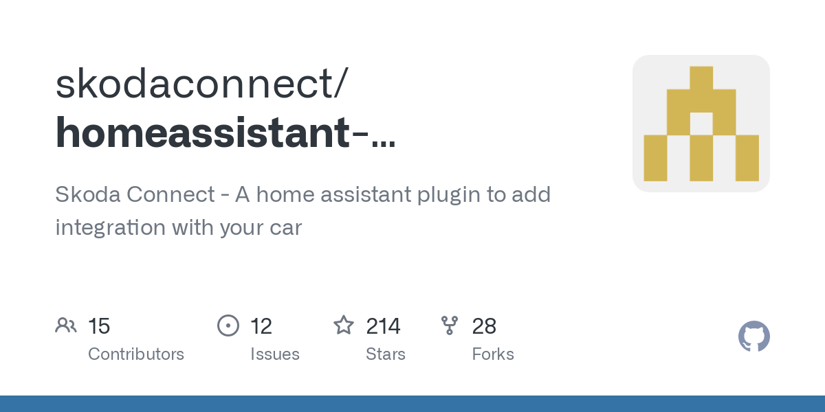

Wie ich oben bereits schrieb: Das Plugin für Home Assistant ist noch nicht auf MySkoda umgestellt.
GitHub - skodaconnect/homeassistant-skodaconnect: Skoda Connect - A home assistant plugin to add integration with your carSkoda Connect - A home assistant plugin to add integration with your car - skodaconnect/homeassistant-skodaconnectgithub.com„If you are unable to use the Skoda Essentials account the integration will not work for you. This is the case for new vehicles and/or Skoda accounts.“
